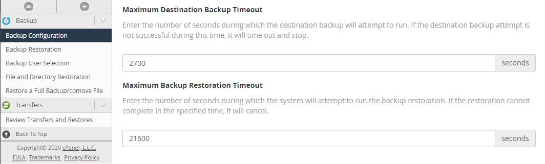

Here's where those settings that JonathanKW mentioned are located:

The Maximum destination backup timeout was at the default setting, I think it was 2700 which is 45 minutes. I have now changed it to 6 hours.
The whole log from beginning to end is little more than 20 minutes, 21:39 to 22:02 so, yeah, certainly no where near the 45 minute timeout limit. If it couldn't reach S3 then you would think it would actually log that fact...not much of a log if it doesn't LOL
