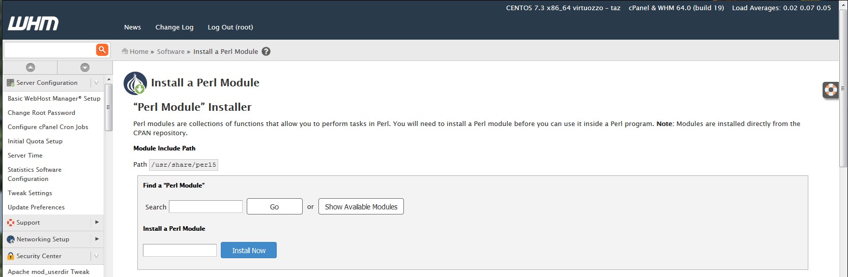

Does your Install a Perl Module window look like this?
install-a-perl-module-jpg.346
If I put net::dns into the search box there and hit the Go button I get 2 pages of results. The ninth of which is the module you're looking for.
Dan, that's very odd. I was about to share a screenshot of what I saw yesterday (only the 2 listings I mentioned in my first post), but just now, when I performed the exact same search I did last night, that whole long list came up. I don't know what or how it happened. I promise you I wasn't smokin' anything funny and what I reported in this thread yesterday was just as I saw it. I'm gonna quit scratchin' my head, 'cause I can't afford any more hair loss. The Perl Module is installed now. On to step 3. :)
